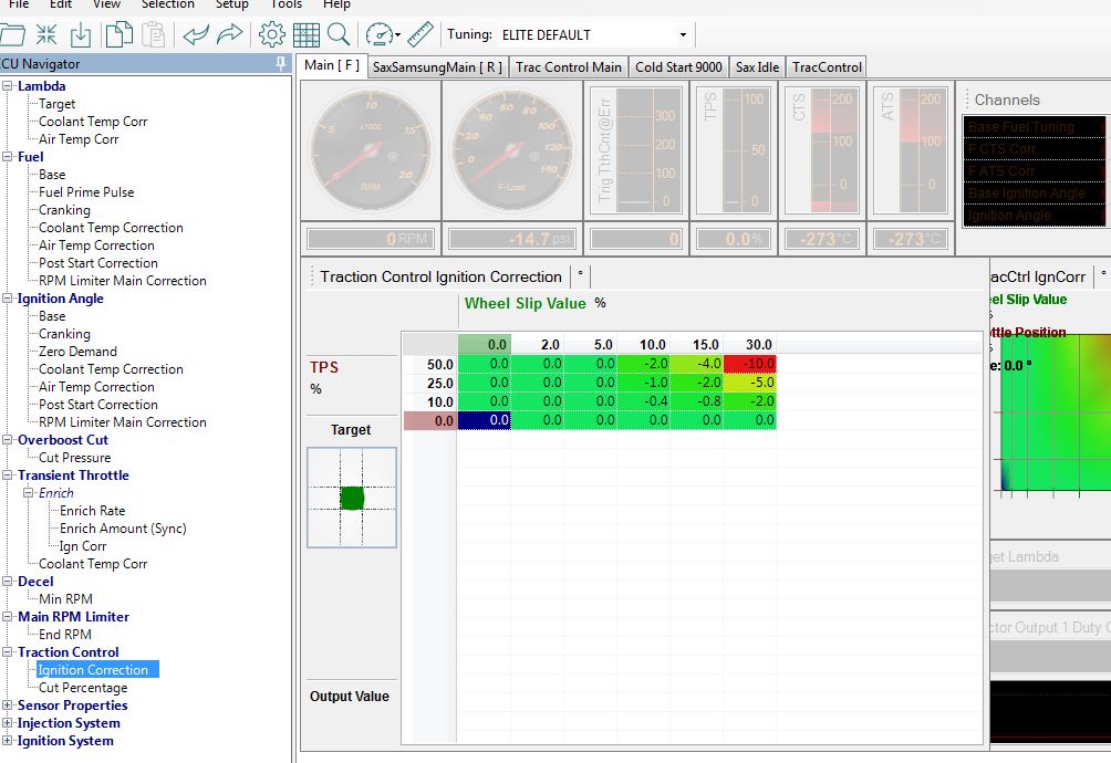

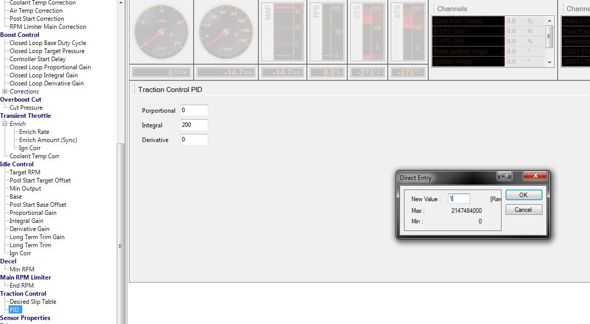

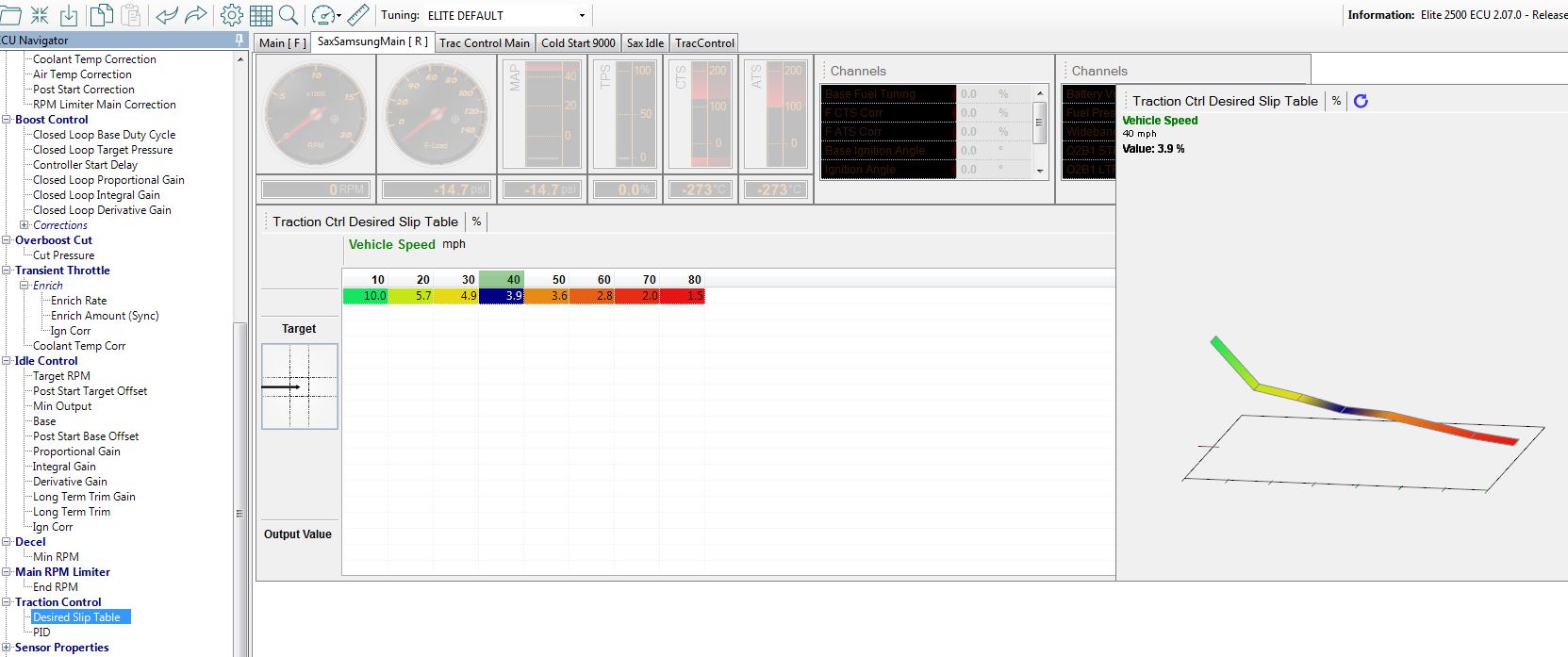

Haltech'c firmware 2.07/2.08 had in theory the best version of the traction. You built a really simple table that had desired slip percentage in relationship to vehicle speed and it took care of everything else in the background. The problem with this setup is that their PID control system supporting it had bugs and if it had to correct for much slip at all it would over shoot.
Setup table
PID issue....adjustable range of 1 to two billion

The best working version of their software is 2.05 for traction control.
It allows you to build a tables where you can directly control ignition retard. This method is a little more labor intensive to dial in on the street but works really well. The downside is that this version of the firmware can't be wired to a toggle switch to turn traction on / off without a laptop in the car with you.
